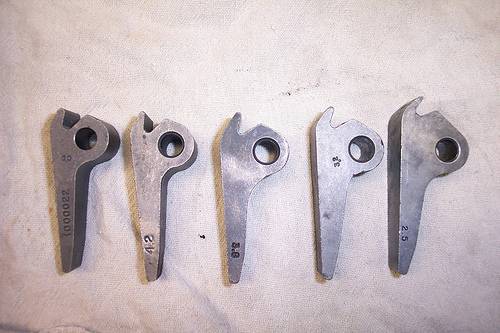

Are the lever's marked with the different numbers? Never been inside an Auto so just curious.

All depends on what the trans application was from the factory. The common low perf were in the 2's, higher power got the higher number. Read my post #3.
The lower the number the less band apply pressure you get.
IMO only the Hemi got 5.0 lever stock with wide drum & wide band
The various levers.
