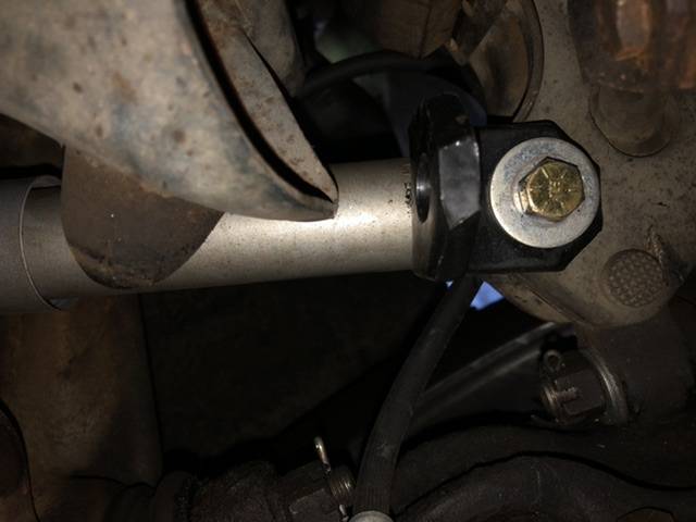

Curious about other people’s experiences. ‘64 Sport Fury. Front suspension completely fresh, .92” torsion bars. 426W. Drove it for some time without a sway bar, no issues, actually didn’t lean much. Put in a year-correct clamp on style sway bar with all new rubber, everything properly tight. Very flat around corners now but big bumps give a real bang out of the suspension. Not sure why. Everything is tight, no backlash etc. is it just due to the extra stiffness?
New rod ends, ball joints, all rubber, shocks. Factory parts, not urethane. Proper alignment. 16x7 wheels with 235/60-16s. Rear suspension fresh too but the noise is certainly from the front.

I’m going to pop the front wheels off and have a close look. You may be right though, it’s notably stiffer than before.

Got it! Lazy me! I had left the Helliwig brackets on after I gave up on it (discs). I had to move them though to miss the sway bar clamps. They whack the down travel rebound mount.
I took a look under my car also, and I see no signs of anything making contact where it shouldn't be.
