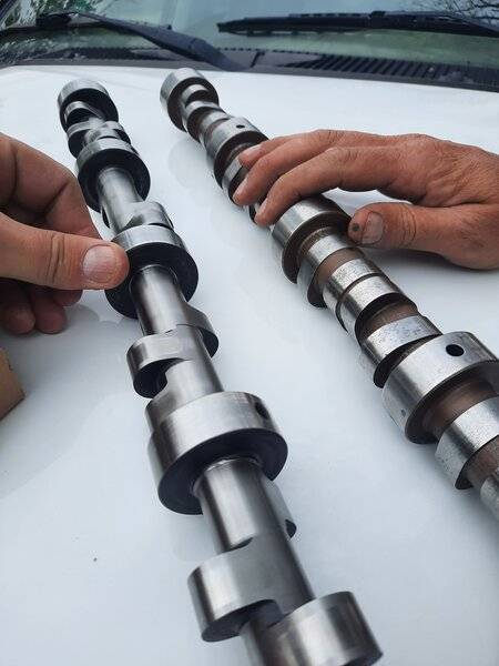

You can see the difference on the base circle on these two roller cams we have. A old street roller .530 lift on the right...superstock roller .730 lift on the left
I think I get it now. I was comparing it to my old cam that had same intake and exhaust lift.
I just have to balance out the pre load and I think it will be ok.
