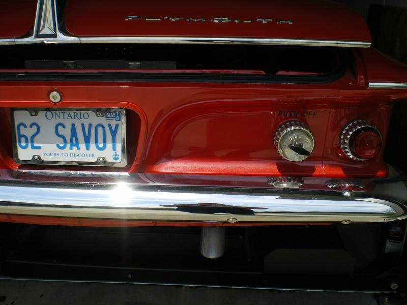

I got around to installing mine. I did not want to cut a hole in my car so I ended up drilling a hole in upper right corner of the L/R taillite lens. That way if I ever take it out all I have to do is replace the lens. Its a push-pull type switch and I bolted to the side of my battery box in the trunk. Ron

After I weighed my options this seemed best. No way am I drilling a hole in my car so the lens just made more sense to me. I actually have a spare taillite lens. The lite still woks fine as the bulb is in the middle of the housing and this is in the upper right corner. To me it was a no brainer since its no big deal if I ever want to take it out and all I have to do is replace the taillite lens. But I have no plans of ever taking it out. If anything the car will get a little faster over the years.

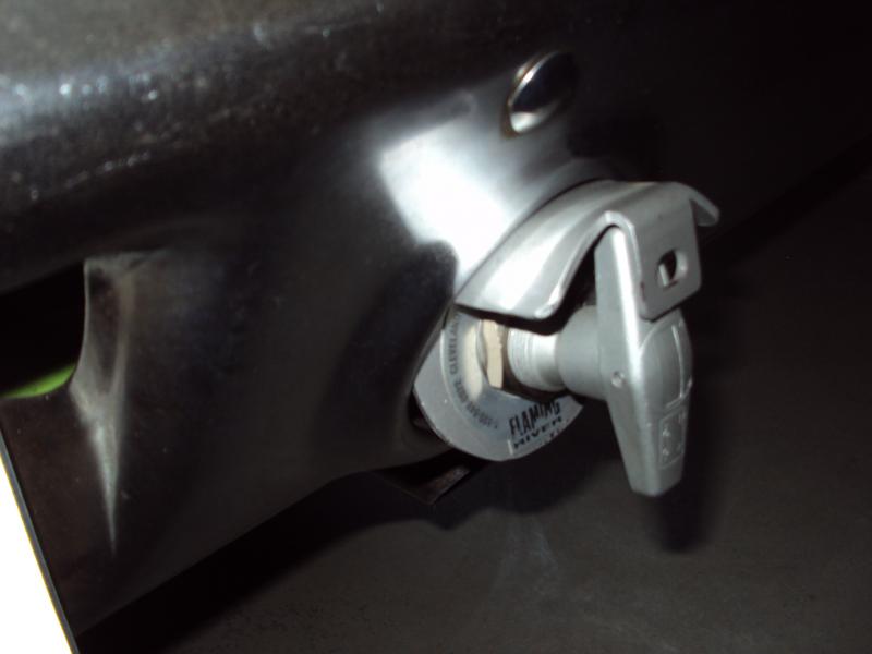

Here's mine. I bought a flaming river cutoff switch and reworked the mount to fit into the original reverse light opening on the bumper. It also has provisions for a padlock to lock in the off position.

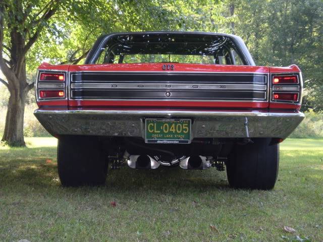

Looks good, I did the same with mine, I hate cutting holes in good sheetmetal:blob1:

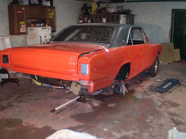

here's mine on the dart, mounted it under the bumper

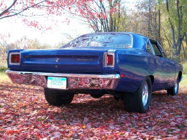

it was already done on my road chicken when i got it, they stuck it where the back up light goes.
