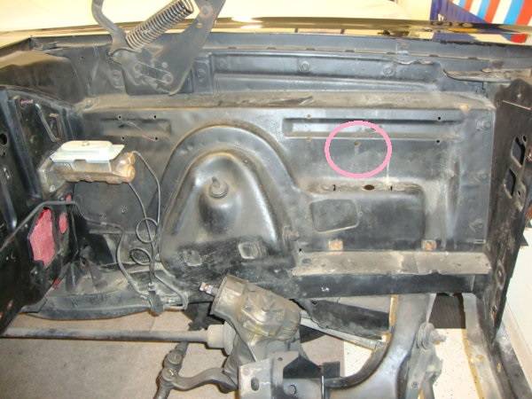

Don't both J-bolts go in the sides of the battery tray ???
The inner one does. Outer hooks in hole as pictured.
From the rear face of the radiator support it's 11.25" (286mm) on center and 1/2" (13mm) on center, down from the bottom ridge of the recessed channel. Hole diameter is 3/8" (9.5mm).
Thank you thats perfect
