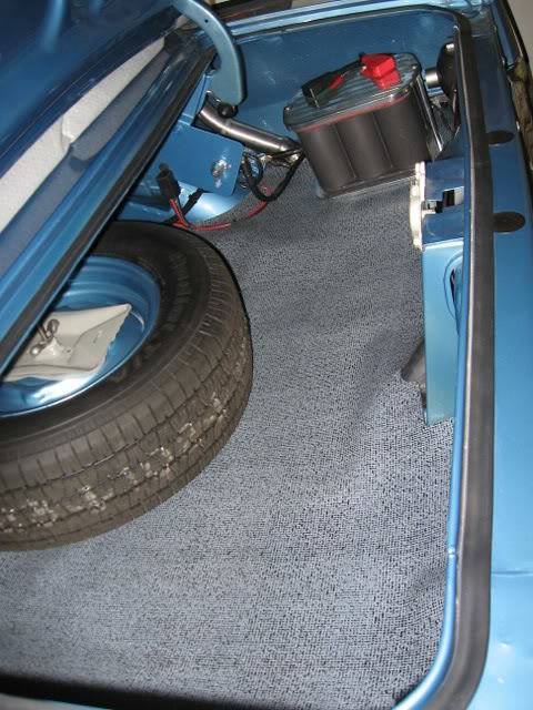

I put the battery in the trunk of my Cuda.
Looking at 65hemi's posted picture it looks like the gas filler line (the silver pipe below the hinge) is adjacent to the battery. I've thought about moving my battery to the trunk and wondered about gas fumes and sparks inside the trunk area. How is that addressed and prevented?
The silver pipe is not the gas filler line, just the old gas tank vapour separator. Gas filler is behind the licence plate and gas tank is vented to outside. Should be no fumes in the trunk or cabin. Battery is a sealed Optima.
E body Barracuda all have the tank fill behind the license plate. A Challenger fill IS on the right side of the car but like mentioned, should never be any gas fumes in the trunk. Is there is, you have a leak somewhere.

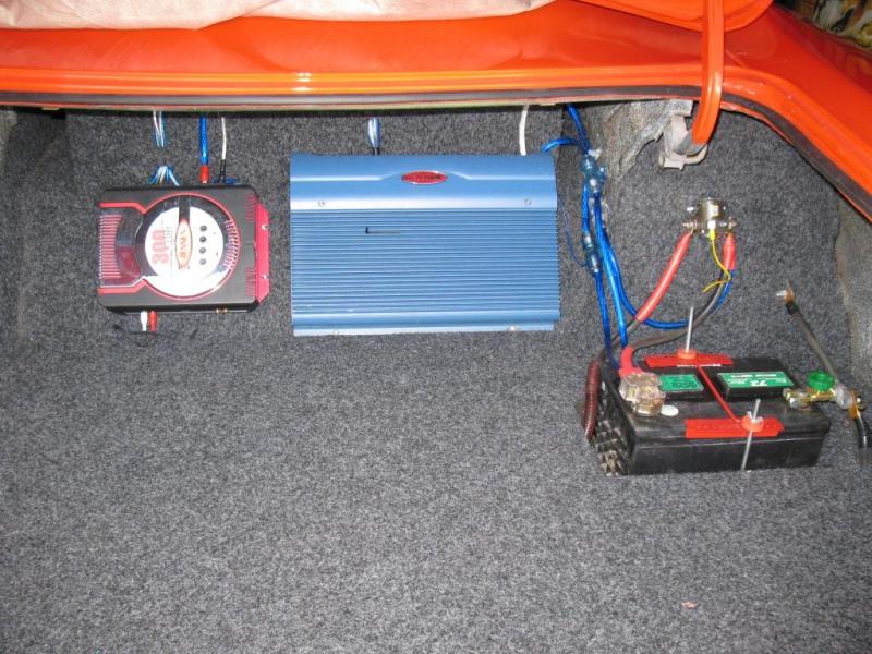

Here is the one I did in my old 68 Runner. The battery box was resessed into the trunk floor for a better look.
I used 0/1 welding cable for postive and ground.
