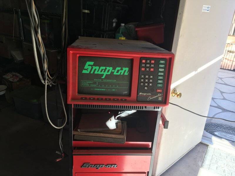

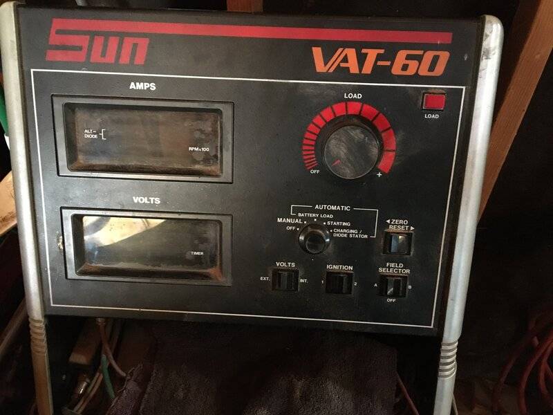

I take the Guess work out. I dont like the hand held testers like Midtronics, I have proven them inaccurate. Give me good old U.S.A. tech. VAT 60 for the battery Scope for alternator wave form.
