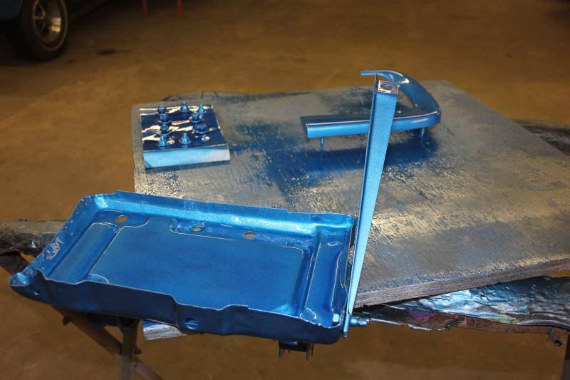

Is the two braces under the battery tray the only ones on it. Or am I missing something like brackets on both ends. Lots of holes in this tray. Thanks in advance. You guys always have the answer.
2 braces underneath, one brace on the forward end that goes to the inner fender. This is not my car/battery tray, but gives you an idea:
Dale
SW MI
2 under the tray that bolt to the bottom of the apron, and 1 above at the front, which also bolts to the apron.
Look for threaded inserts at the bolt locations.
All of it including the tray were body color, painted assembled.
Here's the upper; the lowers are kind of a W shape, for lack of a better description; all are stampings.
