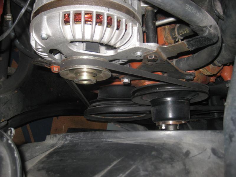

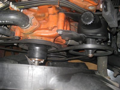

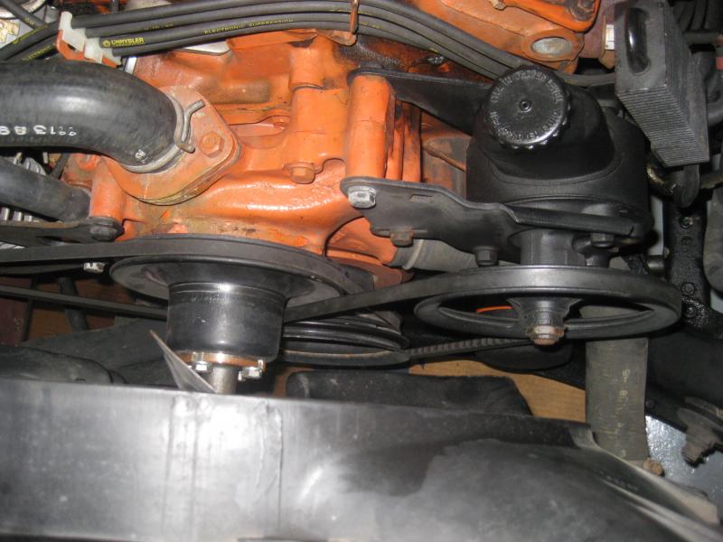

I am trying to figger out what pulleys I need, and how the belts are routed. It is a 440 with power steering only. I have it mounted. I have a two groove water pump pulley, but it hits the crank pulley which is 7 1/4 " diameter. Could you folks post some pics of various set ups. Thanks for any help.........................MO
Alternator and water pump go on back pulley of crank, power steering to front pulley on crank, hope this helps.
Thank you! I think those pics show exactly what I need. Now I see why there are different sized groove dia. on the crank pulley. I think a single groove, deep water pump pulley will fix me up..............................MO
Thanks to all that helped. The pics showed what I need in the way of pulleys and belt routing. I found what I needed in my spare parts pile, so I don't need to order any pulleys.
My Alt. mount was a big hunk of iron for A/C applications, so I ordered the complete Alt. mount kit from Bouchillin(sp). That will tidy things up a lot. Good stuff at good prices. .............................MO
