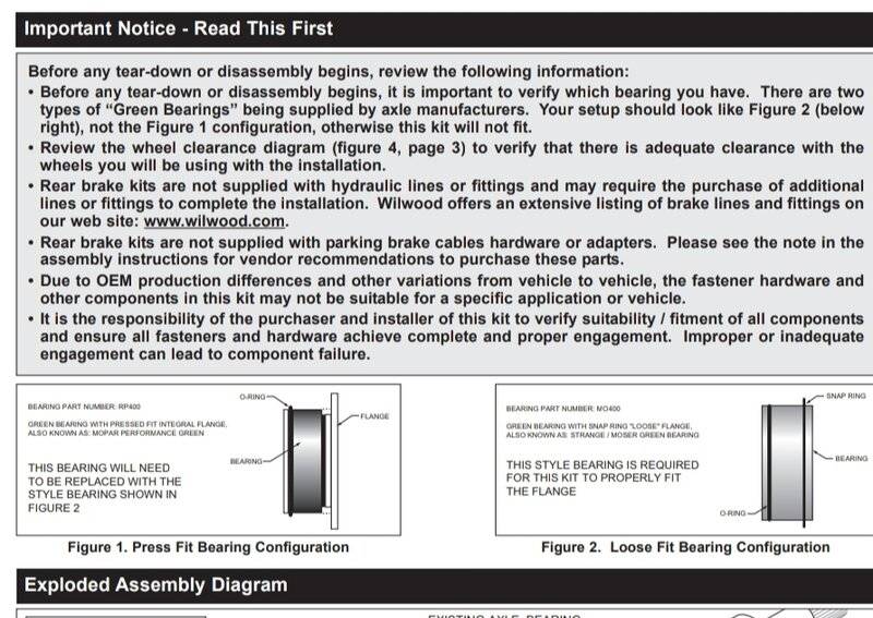

Is there a better bearing setup for this other than the 'Green' style ball bearing without having to redesign the rear end housing or do a complete housing swap? Is there a way to make the Timkens work without doing a major redesign to the housing? @RJRENTON dit ones fo you! :D

Wilwood insists on the Strange/Moser "loose fit" snap ring green bearings.
There are several kits on the market that can be used with tapered bearings. Dr diff has two of them.
Any references or part/kit numbers? There's been a member or two on here that were using the taypered bearing with their rear disc conversions.

Dr diff doesn't seem to use part numbers, but they are in the brake section on his website. He is out of the 10.7"size but the 11.7" are in stock. In a nutshell, any kit that mounts the caliper adaptors on the outside of the bearing retainers, and supplies a spacer to replace the backing plates should work. The other type of mount is the Dr diff type that uses a caliper mount the same thickness as the backing plate, and is used to replace the plate.

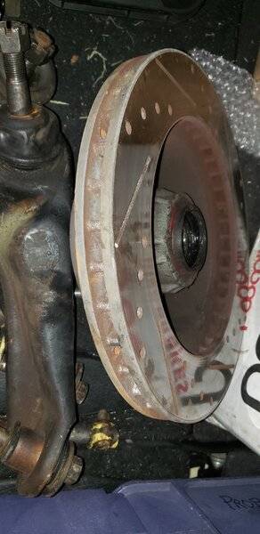

I just picked up all my old brake parts yesterday from the shop that's transforming my RR. The drilled and slotted discs still are thick and in great shape. I think that zinc plating option helped, and very low miles of course.
