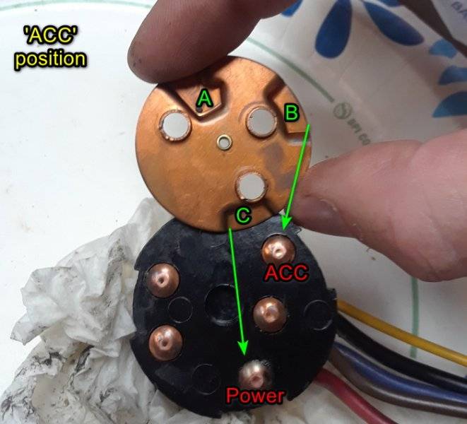

I ended up taking one of the old switches apart to see the inner workings. I could see no reason for a lack of continuity in ACC in the design, unless the copper wheel is somehow tilting in the housing & not making contact? Just weird all 3 were the same, and all were good everywhere else.

Followed a hunch and installed the new switch in the column I'm rebuilding. And discovered there are FIVE key positions, not four as I thought.
ACC -- OFF -- ??? -- RUN -- START
Outside the column, I wasn't using enough force (for fear of forcing/breaking something) to get into the ACC position, but once in the column & working with the key cylinder, it rotated one more click CCW from what I'd previously thought was accessory.
