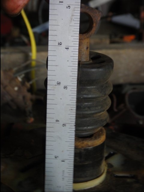

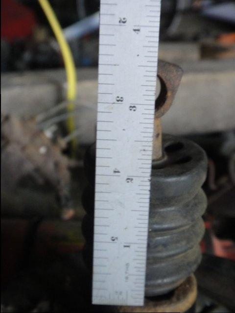

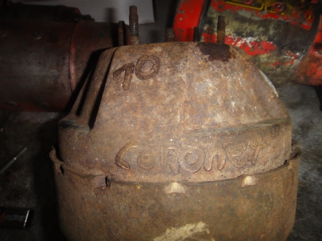

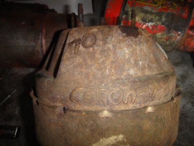

Can anyone tell me if this booster is correct for a 2nd gen b body? The studs are correct for both the master cylinder and the backing plate. I can't find any numbers on the booster. The guy I bought it off of claims it is off a 70 coronet. Are there any other ways to determine if it is correct? I am guessing it is off a 68 thru 70 c body (the end of the rod isn't round). Thanks

Even if that is from a c body it is the same booster. It would just have a different length push rod. If you send it to be rebuilt just tell the rebuilder you need it for a B body and he will install the correct rod. At least that is what Prior Brake did for me.
I agree, send it to a rebuilder and they can make it fit your application. The Ram Man in Texas did one for my Hemi Charger. He supplied the core and all brackets/hardware ready to bolt on.
