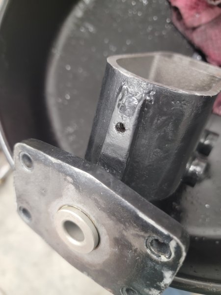

Here you go. The booster that's on the car has the pushrod screwed all the way in and .2 ground off the end. This modification gives me .020 clearance between the pushrod and master plunger. The rusty booster came on my car and the plunger is sitting about .940 in length.

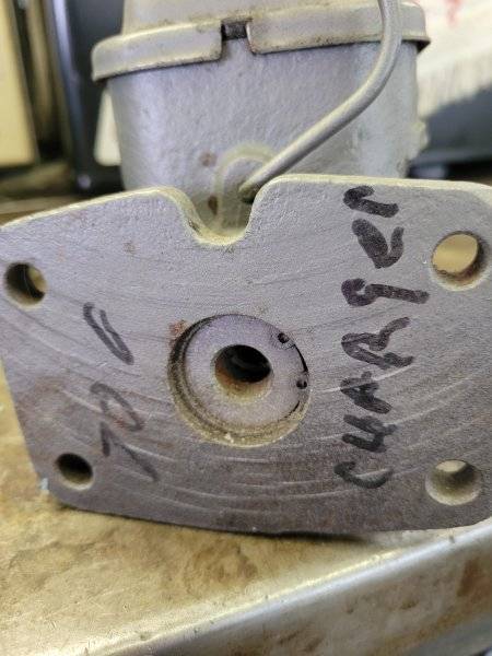

The two master cylinders are an original p/n master and a factory replacement master that was mounted on the rusty booster. Both have a plunger depth of .750.
If I use the .910 fsm length, the plunger pushes in .160 and the plunger will sit flush with mounting surface instead of protruding like it does.
Logic would say put it together like it was with the .910 dimension, but that preload the master. Is that facory? Grinding 2 tenths off the end of the adjusting nut to achieve a .020 gap doesn't make sense.
Ah okay.... yes I believe the piston should be flush, that's your aggravation. So your thoughts would be correct. Is there a small bolt on the bottom? That should be there to retain the piston. I haven't dissected one of those, but I suspect possibly the end of the bolt is not shaped properly? To hold the piston in further.. if your old one has the bolt , take it out so we can see?

Thank you. Very interesting. This is the MC that came with the booster I put on for a guy last summer. It doesn't have the retaining bolt on the bottom.
Not sure what it's technically from
