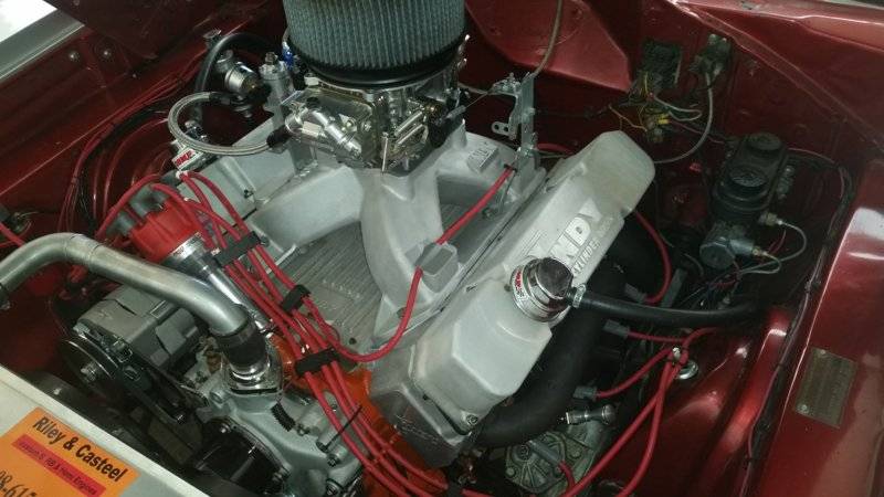

Also, I do have my 5-7 plug wires separated ( #7 runs down the top of the intake manifold, around the back of the block and then to #7). I don't know if separating them is a real benefit or solves a real problem but I did it anyway because, why not ?

I run my #7 wire up past the carb, around the back of the block to the #7 plug.
Up near the Distributor where the wires are going thru the looms I have the #7 wire separated from the #5 wire by putting the #3 wire in between them.
