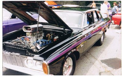

:icon_rambo: I respectfully disagree:blob1:
me too Rusty, I don't know were that came from either, but it's wrong about the K&N filter not filtering anything, they may not filter as good as a paper filter, but they are also far superior in flow, to any paper filter, hands down, they are cleanable & have to be maintained & spritzed with filter oil after cleaning....
