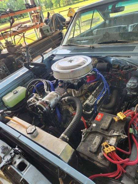

Been have trouble with my 2 pieced together 4 wheel disc. 72 charger k member with disc brakes on front and right stuff disc brakes on rear. Was considering a whole swap over to a single manufacturer to get the brakes right and sell the old ones to upset the cost. On that note what is every one think the best bang for the buck on 4 wheel disc brakes? I know cheap and disc brakes don't mix. But Baer seem nice for about $3k

I have another thread going for my problem of soft pedal and not adequate braking to my liking. 3 pumps of pedal touching the firewall to get something to lock up on rocks compared to the first pump that may slightly move rocks. Small block 408 stroker doesn't make enough vacuum to use a booster

Pedal feels spongey, can touch fire wall with pedal and not a lot of stopping power. First pump on rock it might skid 1 or 2 rocks. The 3rd pump will actually skid quite a few rocks. I know sounds like air in the system. I have a 15/16 bore master, adjustable proportion valve for rear and distribution block. Just checked a few minutes ago. Calipers seem aligned. The hoses on the rear have A LOT of movement. Both hoses on the front do not have hardly any movement. I'm thinking changing the master to 1" bore to maybe stiffen the pedal a little and have a little more fluid volume per pedal push. Put 2lb residual valves inline. Changing the rear hoses to stainless steel line. Don't know where I would get those lines since it is a banjo bolt on one end. Will probably have to Google a master cyclinder.
Strange the rear hoses have alot of movement?
I'm thinking the rear caliper piston seals are partly stuck, pulling the pistons too far back? (a design of the square cut piston seals)
you might have to temporarly increase the rear brake pressure, and pound the brakes hard to get the rear pistons and seals to move closer to the discs to reduce the distance the pistons move. Also, check the disc for run-out if that dosen't help.
