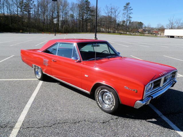

When reaching 50-55 MPH, my rebuilt 440 engine in my '66 Coronet starts to skip, needing gas faster. A new 6 PSI fuel pump was used during the rebuild. Which mechanical pump should I upgrade to so this problem will stop?
