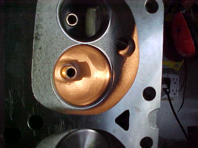

This is a shot of the intake pocket (or bowl) of a Eddy RPM head. Compare it with a stock pocket and you'll see why stock heads flow kinda crappy
Exhaust side. These are out of the box so they could be touched up...
Yea those are some awesome looking ports! If I can afford some after market Alum heads closed chamber, I may buy them.
