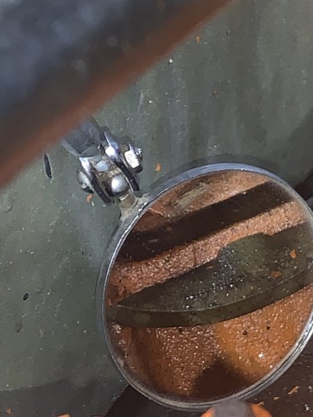

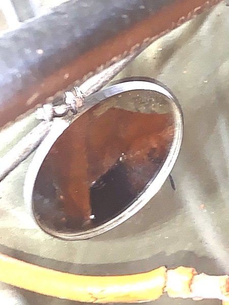

Doing some diagnostic work .
Dug out a bore scope toy I picked up a few months back.
Sure enough, I have a sucked intake gasket in at least 2 places.

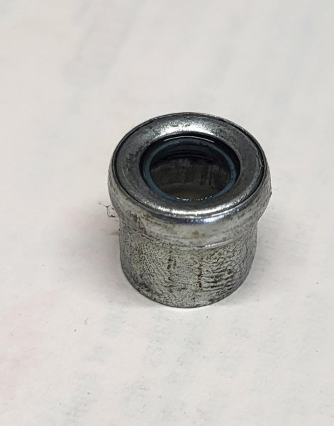

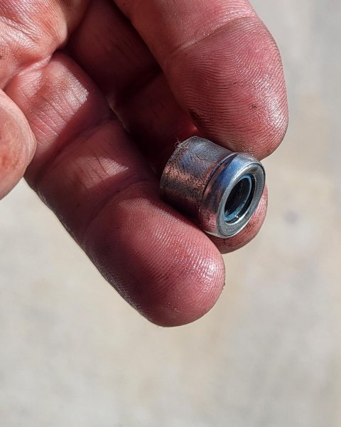

Are these stock Hemi valve guides ??? I know these are NOT OEM valve guide seals
Hard to tell with the oil, but it looks like replacement guides that have been cut for the metal clad positive seal.
I dont think its had guides put in it( cant guarentee that though )
Its been together over 20 years now. And I want to replace the seals and go thru the valves while its opened up.

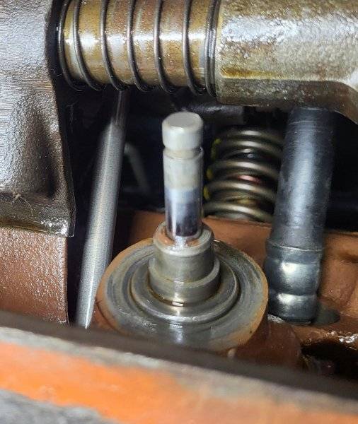

I thought I had a intake gasket sucked up and in. But once apart I dont think that was the case. But yet my intake valves are wet and oily . So next option is seals . worst case guides.
I only have the one spring of so far . And I can feel just the slightest bit of movement in the valve to guide . Whether it not its excessive or Ok IM not sure
If its guides I'll put new seals on it and button it back up to deal with at a later date . When I will actually pull the motor all the way down for a rebuild with new pistons , etc etc
Looks like the guides were machined for those white Perfect Circle seals. Seems like everyone likes the blue Viton seals now. .530 ID is a standard size.

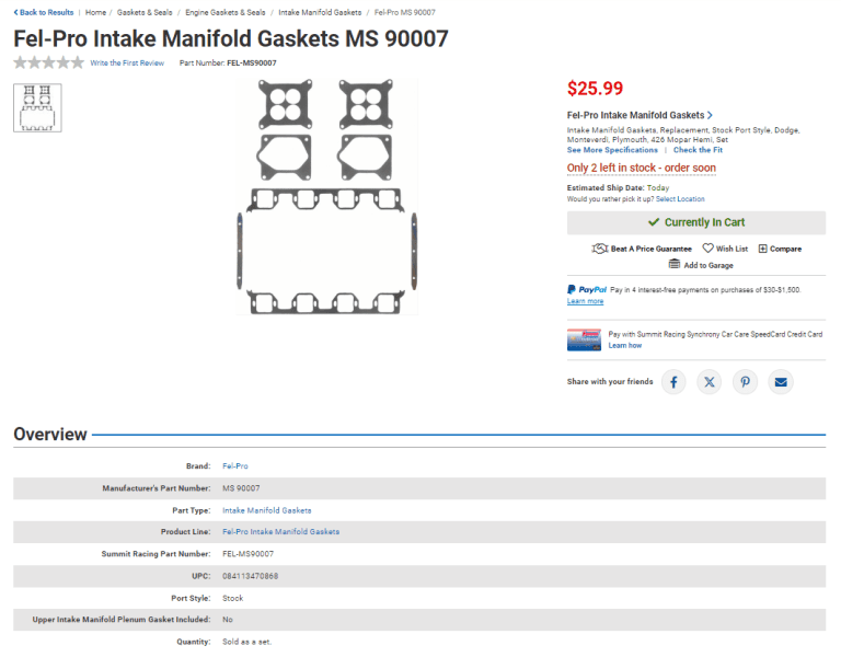

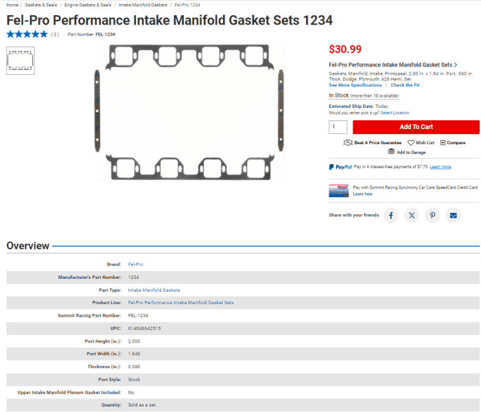

I see two Fel Pro Gasket kits. One Fel Pro 1234. Another MS90007 is for cross ram with carb gaskets, but it less expensive.
I see the Fel Pro 1234 is listed as 0.060" thick intake ports.
I don't see a intake port thickness listed for the MS90007. Do these have the same intake port gaskets as the 1234's ?
I'm not sure but I've used the cheaper ones and they were fine.
