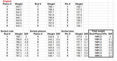

I suddenly remembered that I did weigh also the con rods, and mixed and matched it all to get it as equal as possible:
This is the 512 stroker kit for the 400-block, all in grams:
