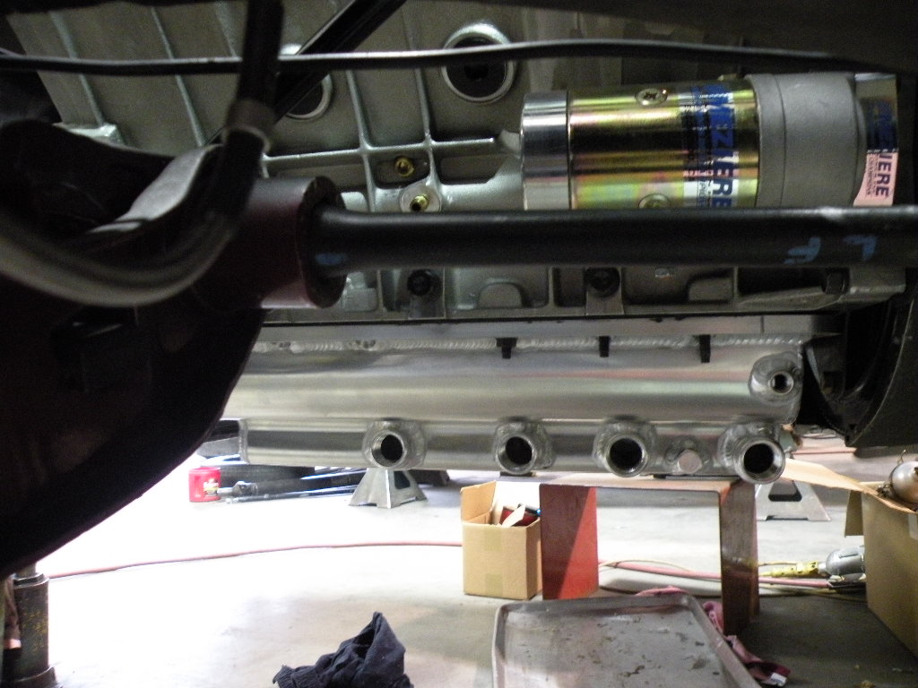

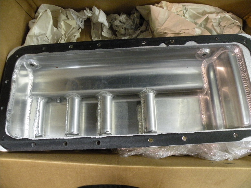

i agree, right stuff by permatex. only downfall is it's a bear to get the pan off with it. buy the felpro blue oil pan gasket and put a bead of the right stuff on the pan 1st. let it dry overnight and then in the morning, a little grease on the other side to the block and just snug down not too tight. no leaks ever.
