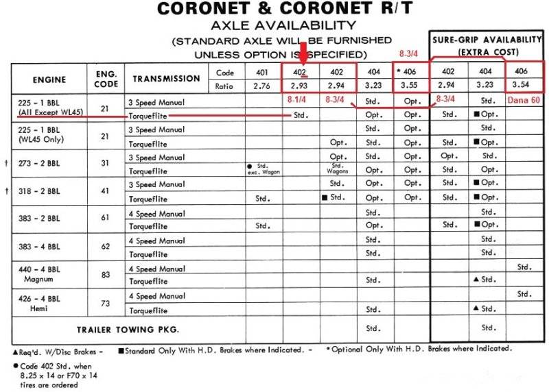

I am new to this site. Own a ‘67 Coronet and starting some rebuilding of brake system. What are best sources for decoding the “2” and “624” on the build sheet for the axle? There has to be sources out there I can use.
Thanks in advance for your help.
