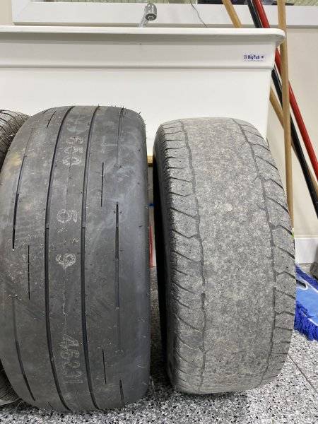

I found a better idea for burning the rubber on BFG T/A radials.......
:lol:
