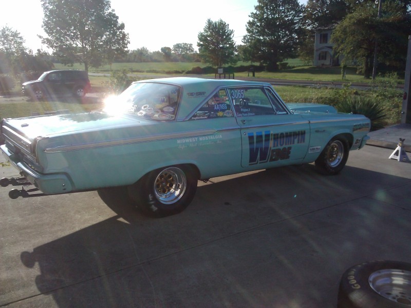

I have a stock length rearend in my 65'Coronet and I run10.5wx29.5 on a
12" rim. It has a 7" backspace to the inside.
