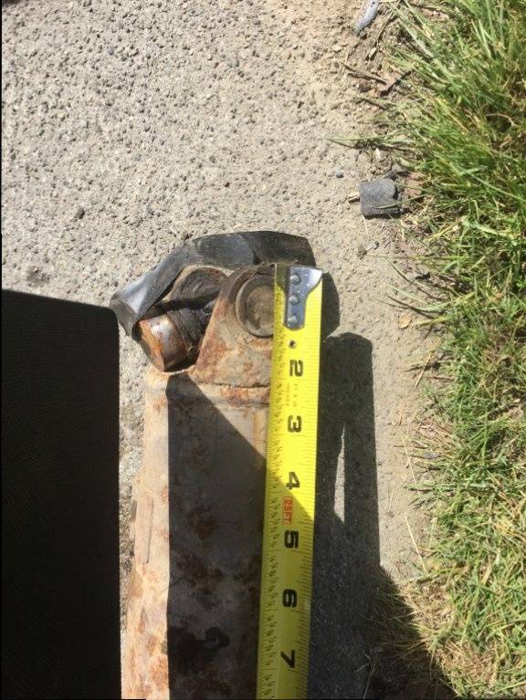

Mine (383/727), measuring from the top of the u joint to the end of the yoke is 63 3/4". Came with the car, I assume it is the original, but I've never installed it so someone should probably confirm I have the right one. But I wanted to try and be helpful, since these guys have been so helpful for me.

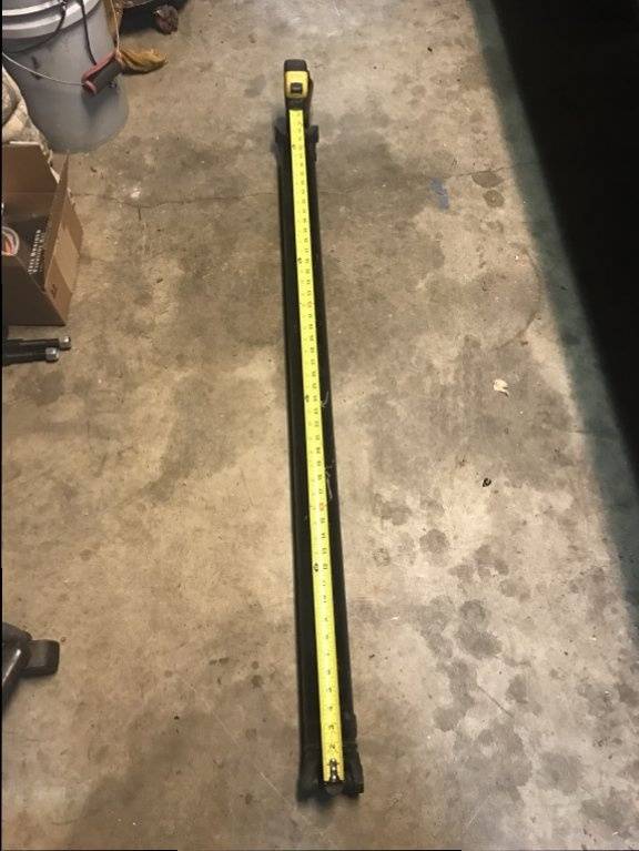

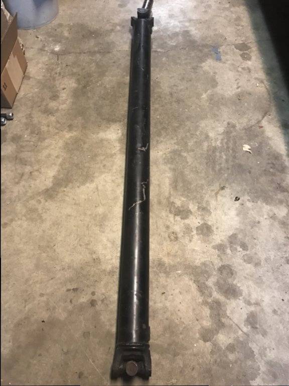

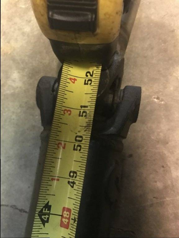

Mine measure almost exactly 52 center to center. 67 coronet 440/727 8 3/4 742 case

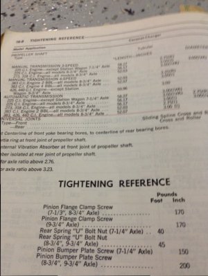

Right out of a '68 FSM- 47.81" from centerline of frt.yoke brg .bores to centerline of rear brg. bores.Sticks were 51.53" for BB.SB were 52.27"
Quickster I'm sorry was on Dart page. 52.07" for 383&up for an auto.Stick shows 50.96" with a Dana, 52.07 for a 383.

Ok the measurement for SB is 56.17" for 273/318 in a body per FSM. THEN you COULD have a "taxi" 318 with a 'big' 727. My book doesn't say anything about length.

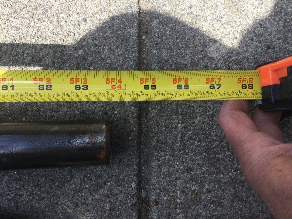

View attachment 421229 View attachment 421230
That's not how you measure driveshaft length. You measure center of U joint to center of U joint. There are more than than one front yoke length. FYI
