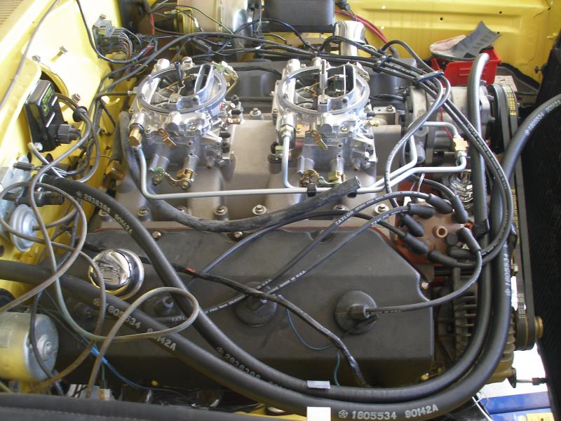

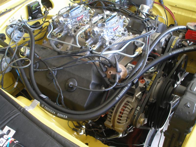

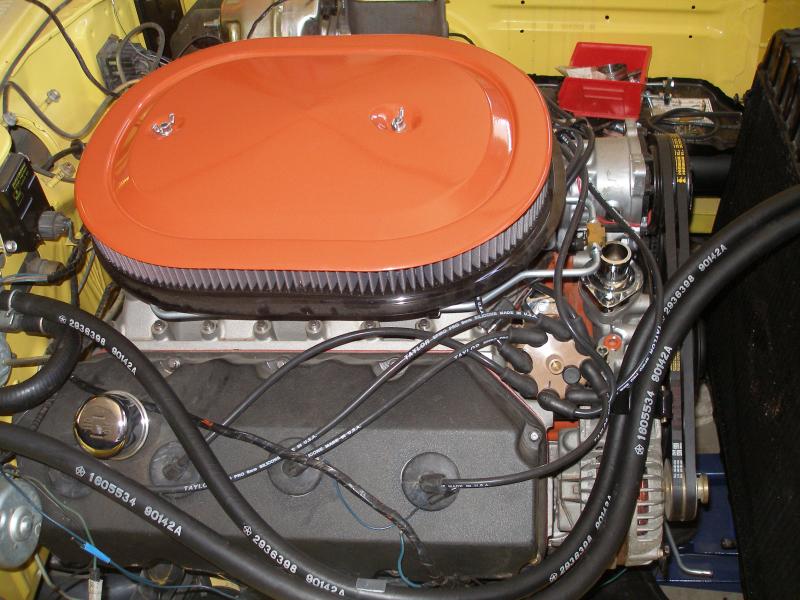

2. 440 AND 383 brackets ARE the same when it comes to AC, Pwr steering AND alternator.
So; armed with this info you have a start.
I had to piece together "stuff" for my application on the 70 Bee...
No Hemi came with AC so I had a lot of figuring to do...
PS: Randy at Bouchillions (BPE) helped me with TECH advice.
See pic below:
These are 440/383 brackets.
