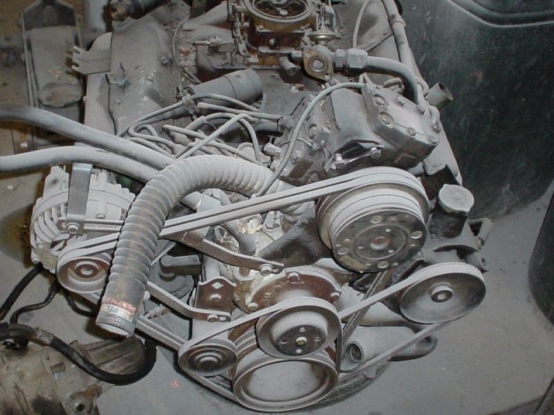

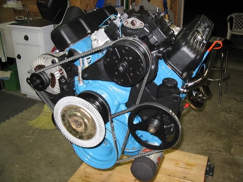

Not sure but this may help...
I found the picture on the right, too - it's for a 1976 Winnebago so I didn't know if it would be the same as for 1973 B-bodies, otherwise I would just copy that and call it good. The alternator brackets on the left engine don't look familiar: maybe it's a sixties engine? Look at the difference in power steering pump pulley sizes between these two engines! I have the Federal style PS pump like the engine on the left but with a large three spoke pulley like the engine on the right. I don't even know if this is as it should be.
I wish there were reproduction assembly manuals available for Mopars like there is for GM vehicles because the different belt and pulley arrangements are spelled out very clearly in them. I have a 1973 Chrysler service manual and this isn't mentioned at all in it. I can't even find anything doing Google searches other than the above picture.

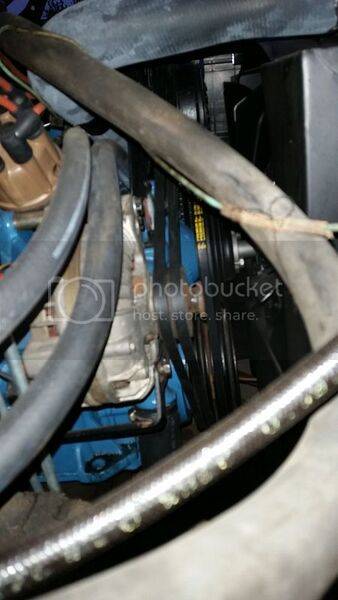

These are on my 1974 440 pickup with ps and factory air. Double belts around crank, ac, and alternator. Single belt water pump, crank, and ps pump. No idle pulley like the above pic has
That's what I was thinking it might have been like - without the idler. Was the double groove pulley on the water pump also the way it was originally?
It has a double groove pulley on water pump but only 1 groove is being used. It's the pulley bracket set up that came on it. I just cleaned and painted everything, new belts hoses etc when I got it.

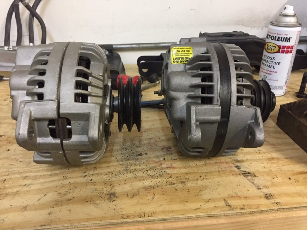

I've looked high and low on eBay and I've never seen an single groove alternator pulley that looks like it would work. Either double groove pulleys like yours must have been used, a deep pulley with a spacer used, or if single groove pulleys were used they are so rare that they never end up on eBay.

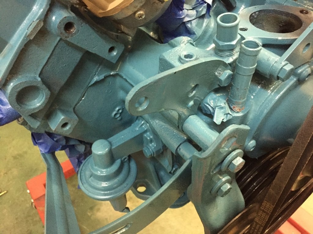

Magvan,

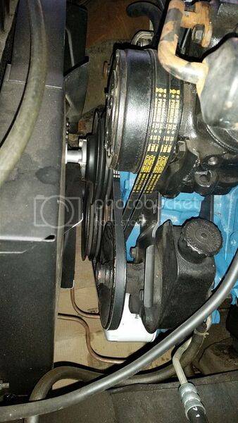

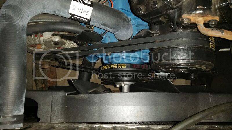

can you post a picture or two of the upper alt bracket and where it bolts to the water pump.
It looks like I'm getting closer. I was mounting my alternator on the inside of the top bracket which explains the issue I was having with the spacers. Once I get this figured out I'm going back to black brackets.
I gotta say magvans got the waterpump housing with the inlet on the passenger side. Think that might make a difference? Never seen one before myself. Interesting. Where are the timing marks?

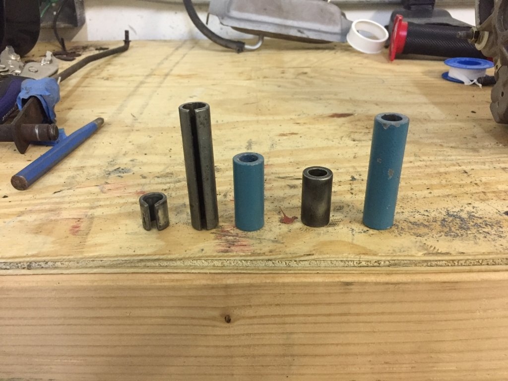

I keep all those spacers I can find.

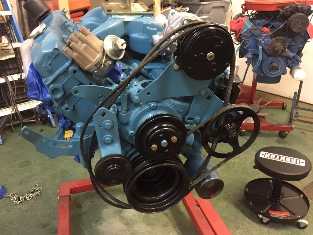

I have a reasonably unmolested 1973 400-2 with a/c from a C body, but it will be tomorrow at the earliest before I can get any pics.
I bought all new pulleys and brackets from bouchelon. I removed the air conditioning from the car. I do have an aftermarket damper and water pump on the 72 400( now 451 ). Before removing, even with the new damper, everything lined up fine after I had to add 1/4 spacers to all the brackets and behind the water pump pulley for alignment. I didn't contact them, but I was quite frustrated thinking shouldn't this just bolt on.
I have the power steering bracket from bouchelon on mine too. I also had to space it to make the pulley line up
