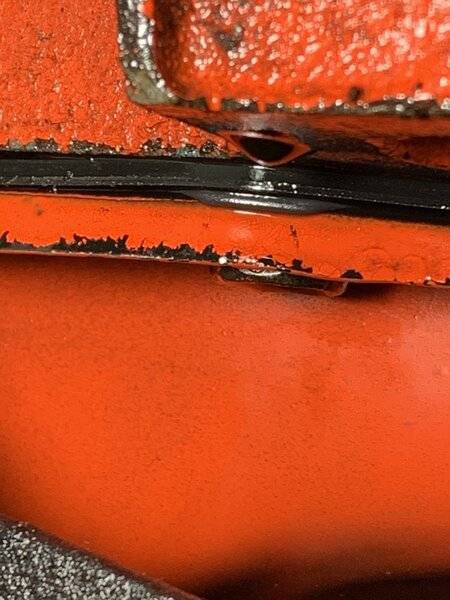

I tried one of those. I couldn’t get the pan off because it was hitting the k frame so I had to send the car into town. They put the tray in and it leaked like crazy. You can see what happened in the picture. Not sure why the seal bulged out at the bolt holes. I contacted summit and they sent me a new one. Haven’t put it in yet.
They probably over torqued it as most do with oil pan bolts and valve cover bolts...

But there are metal "grommets" around the bolt holes that are suppose to prevent overtightening and I'm pretty sure we confirmed that the bolts were only to be tightened to 15 lbs.
That's good most just put them on with air tools...

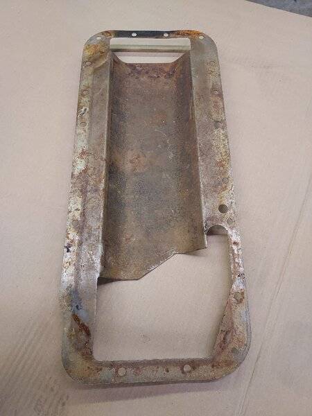

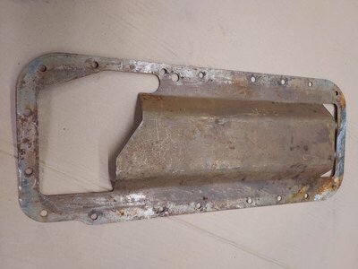

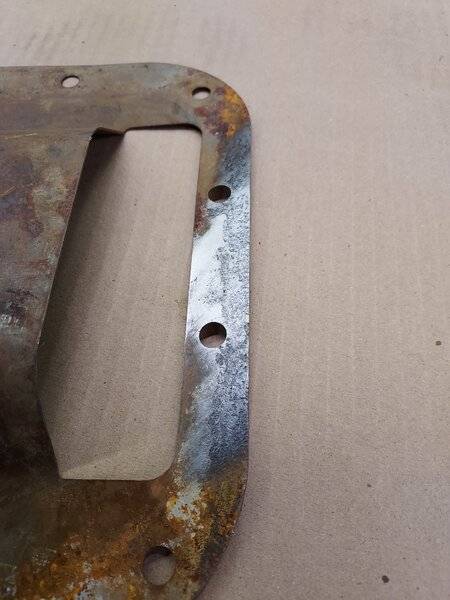

Well I thought I still had a few extras but I guess I'm down to one. Not the nicest one out there.
Just has some mild surface rust except at the back end were it has some pitting. I cleaned it up a bit with the wire wheel so you can see it. Probably will require some sealant. It's yours for shipping if you want to mess with it.
