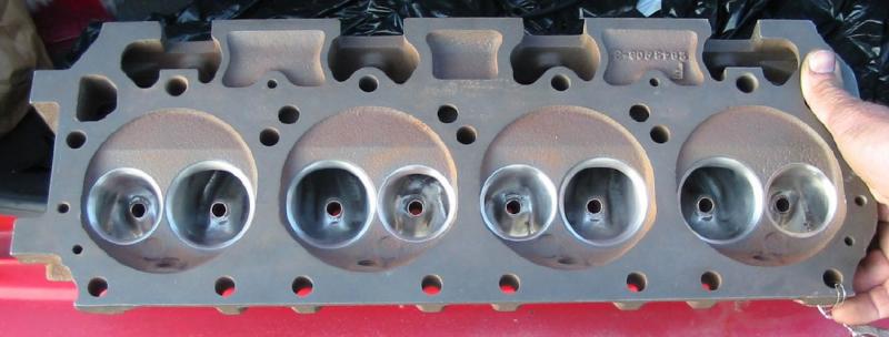

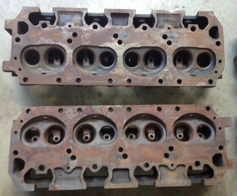

The difference is mostly in the combustion chamber. Here's a pic of the open chamber 906's vs the closed chamber 915's. These are just pix I grabbed from the internet and you'll notice the 906's (2nd pic) have been worked on.
'Open chamber' means the chamber extends above the whole bore (or about the while bore). Closed means it only extends to where the valves are, 'closed' for the rest of the bore.
