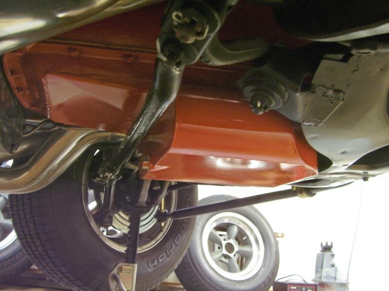

I have a high volume oil pump and figured a deeper pan was a good investment. I have only one issue with my Milodon deep pan......road clearance. I ended up fabbing a skid plate patterned after a later B body hemi plate.
this isn't a very good pic, but i fabbed a "track" type pan for my '65. it has kick outs on the sides and holds 7qts. plenty of road clearance.
Nice work there...my skill set does not fall in the fabrication dept....

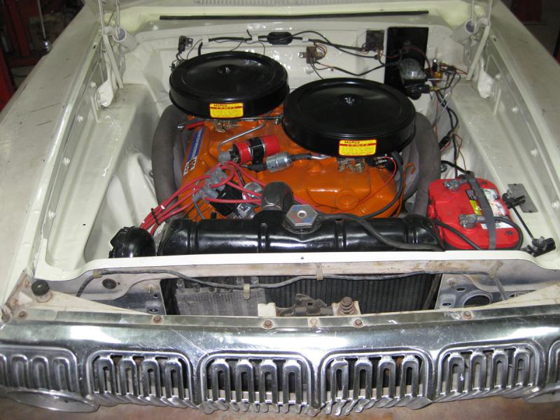

63wagon, once you get 'er in take pics, please!! :icon_sunny:
Will do!
