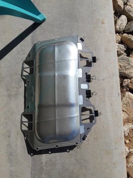

I always use the thin paper on both sides of the bathtub and have never had a leak.
I glue them to the tub and smear a thin layer of grease where they seat on intake & heads, so they pull away nicely.

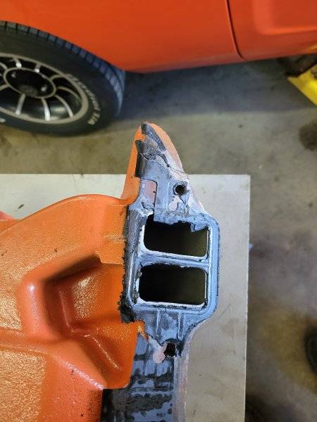

I didn't use the paper gaskets on the last one I installed. In a couple months I noticed a stain starting under the manifold on the valley pan. Sprayed parts cleaner under there and the idle would change. So there was a small leak. Installed just one gasket between the manifold and valley pan and all was good. Went back over the carbs and they came in a little better too.

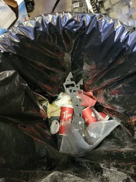

A lot of the point I was making was how f#&cked up those gaskets got. The sniper was covering up how bad the vacuum leaks were, so I'm intrigued to see how much better it runs sealed up, and with a single plane now

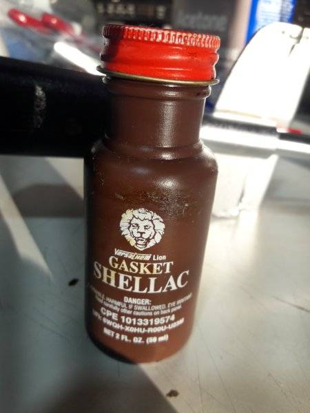

No oil in the valley pan, backfires solved, and car had never run better. Used gasket shellac per Felpro instructions to glue gasket to valley pan.
