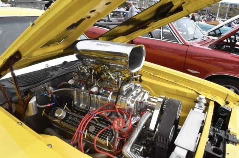

But if you’re willing to spend the $$$$ my Comp Ultra Pro Magnum rockers hold up GREAT on a 900+hp blown big block/4speed pro street car.
