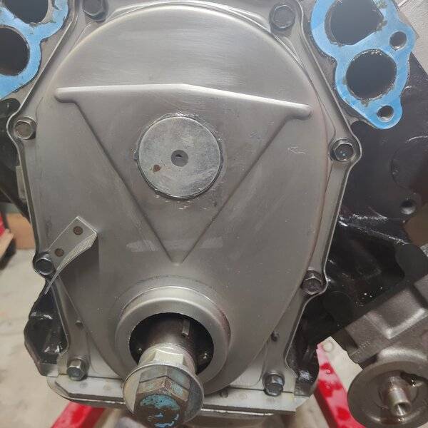

Thanks for the info I am using a nylon button do I need to weld an piece of square stock inside the timing cover to reinforce it or would the cover itself be fine?
No bearing behind my roller cam, used nylon button, had to clearance it a little to fit between cam gear bolts, then put a bunch of putty where the button would go and put gasket and timing cover on and torqued. Removed and measured how thick it was and shaved nylon button down to spec. No issues.
They say the stock cover "can" flex. I used a 440 Source stamped cover, it's a bit thicker and say it won't flex.
Weld the piece to the outside of the cover. The general consensus is reinforcement is necessary on a stock cover. Anything close to .005" is a comfortable clearance for the button. Check with the gasket in place. If you have access to the valley you can check play by moving the cam back and forth. Otherwise you'll need to check with plasticene on the end of the button. If clearance is too tight, grind the button. If its too loose, shim behind the button - pieces of feeler gauge work. No worry of them falling out once the button is in place.
When you weld the washer on.... make sure to mock up the water pump housing with gaskets. I ground the pump and washer, then feeler gauged it to a few thou. Then if the cover does flex, the pump holds it there.
So make a washer Sandwich with water pump and timing cover thanks for the info.
Never messed with this before .
I welded the flat stock on the outside of the cover. With my roller cams and roller thrust buttons. Proper adjustment is required. I used the hammer and multiple measurements.

Wow that's very interesting. I think I will try and fab up something to wedge against the back of the water pump so it can't move .I try and take some pictures of the process.
A big wad of epoxy will do the trick. wrap it in saran before wedging it in there so it doesn't stick to the pump or cover.

That big wad of Por 15 epoxy would be easier! And it will smash in to the correct size when water pump installed and then painted to be not noticeable!
I think I will let it stick to the timing cover so it can not ever move . Seran wrap pump side .
I have used it before it is rock hard I am glad you mentioned it I forget stuff sometimes.

So I been trying to figure this out I fave a large 2 inch diameter washer wedged behind the water pump .the washer is .064 thou thick and cover still flexing with watep pump on
Flex is about .005 to 7 and the cam true clearance is about .004 .
I am worried about the flex.
Nah, nothing to worry about. .010 is acceptable and you're only .001 over. And all this is only "if" the cam walks.

I reinforced my stock cover and noticed how flexy it was -still-, when checking button clearance.
Didn't feel good about it and ended up with the AR engineering cover as well. Very nice
This is what I ended up with .007 true clearance with .064 washer Wedge behind the cast iron water pump housing.
I will flex about another .010 if I force it .
I feel comfortable with it and going to run it .
It's going have to do for now .
