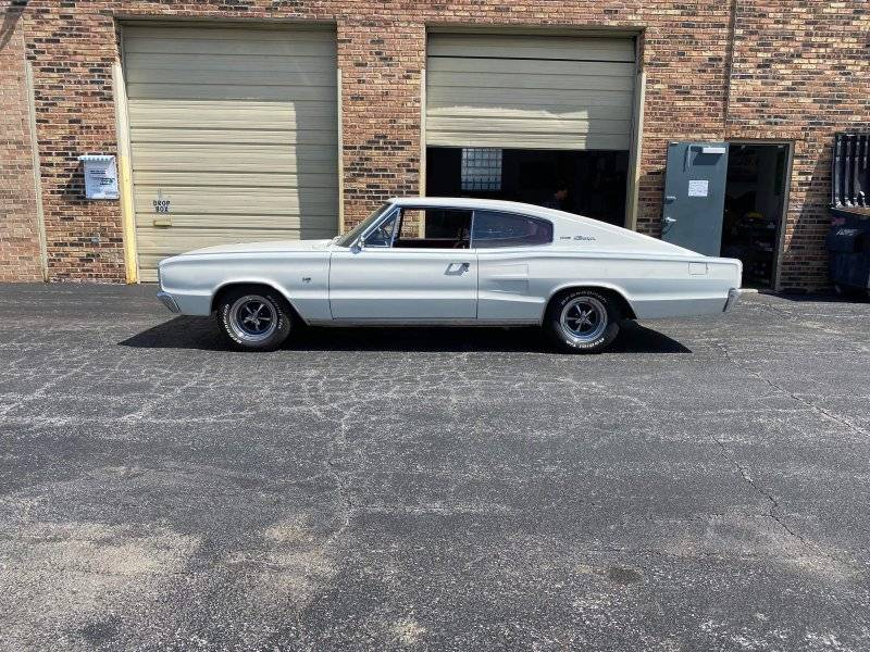

So my wife and I bought our forever home in Cosby Tn which is located in Cocke county. Cosby’s claim to fame is the Moonshine capital of the world. The roads down there are great mountain roads through the Smokys, and our place is between the Tail of the Dragon and the Rattler so I decided to upgrade my 66 Charger’s suspension, brakes, and steering to make it more capable. My mod list is as follows:
Firm Feel:
Stage 3 steering box
Roller bearing idler arm
HD Tie Rods
Hotchkis:
Front sway bar
Strut rods
UCAs
Fox Shocks
Greasable lower pivot / urethane bushings
Torsion bars
Rear sway bar
Leaf springs
Reinforced K Frame W/Hemi skid plate
Reinforced LCAs
Dr Diff:
13” front rotors with 2 piston Cobra rotors
11.7” rear rotors with Cobra calipers and parking brakes
17” American Racing magnum 500s
Ok can’t believe what a huge transformation it’s been the handling, road feel, braking, and even the ride quality are all off the charts. Next phase will be replacing the poly 318 with a TFS headed 470 B block. I’m still on the fence between a 727 Lock up trans/Gear vendors OD or an 18 spline 833/Geqr vendors OD and 3.73 Dana 60

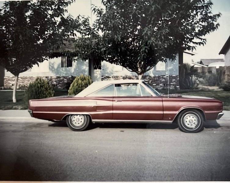

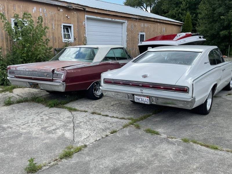

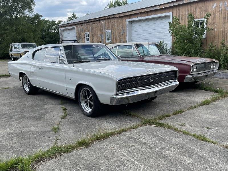

What's the story on the coronet?
Why isn't a 5 or 6 speed trans on the list?
Mike
Don’t want to cut the car up. It’s an 80,000 mile California car that has never had any rust or major damage
Just bought it out of Central California original R/T 440 with AC. I have the ownership history from new. I found the original owners daughter and she sent me a picture from 1977 when she drove it to High School. 100% original. The only thing missing is the original air cleaner. It has a 68 Unsilenced one installed. Going through the cooling system this weekend and going to pull the 1/4 panel on a buddy’s frame table next week. It was parked in neutral and rolled down a hill into a tree. Luckily it missed the deck lid and bumper. I have a replacement 1/4 extension and tail light. I’m going to preserve the Patina and probably go back to the 7.75-14 tires with full hubcaps as they came with the car
