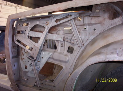

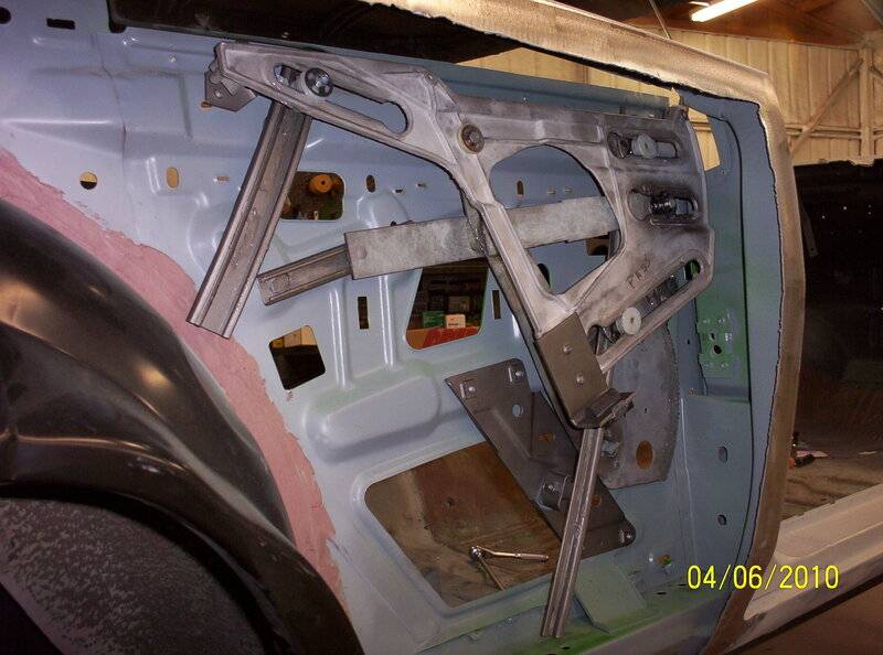

I think the screw inside of your big nut is a eccentric/cam. I might have a pic.
No it is not. It is a simple screw adjuster.
Outside looking in.

I say it's a rubber grommet there's some kind of black donut on the ones that I can see , inside on the adjuster stems . Might just be a build-up of grease and dirt. If I can't get them loose I'll get back tomorrow with some photos

There is no rubber grommets used. There are wide rubber band like rings on the front and rear up stop brackets. There are black paper gaskets and rubber rings where the glass itself attaches to the main frame.
Yeah I got it cleaned up can see that area where the track stud goes through . no grommet, it was just Caked Up with undercoating and grease and grime still haven't got the adjusters loose got them soaking with penetrating oil I guess those studs turn on those tracks hopefully these aren't sezed

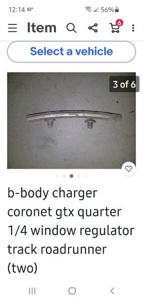

I finally found a picture on eBay of one of those track Adjusters disassembled out of the car now I got it through my thick head how it works and how to take it apart hopefully mine will break free
The old jam nut double threaded Hollow Bolt that I've never seen trick
