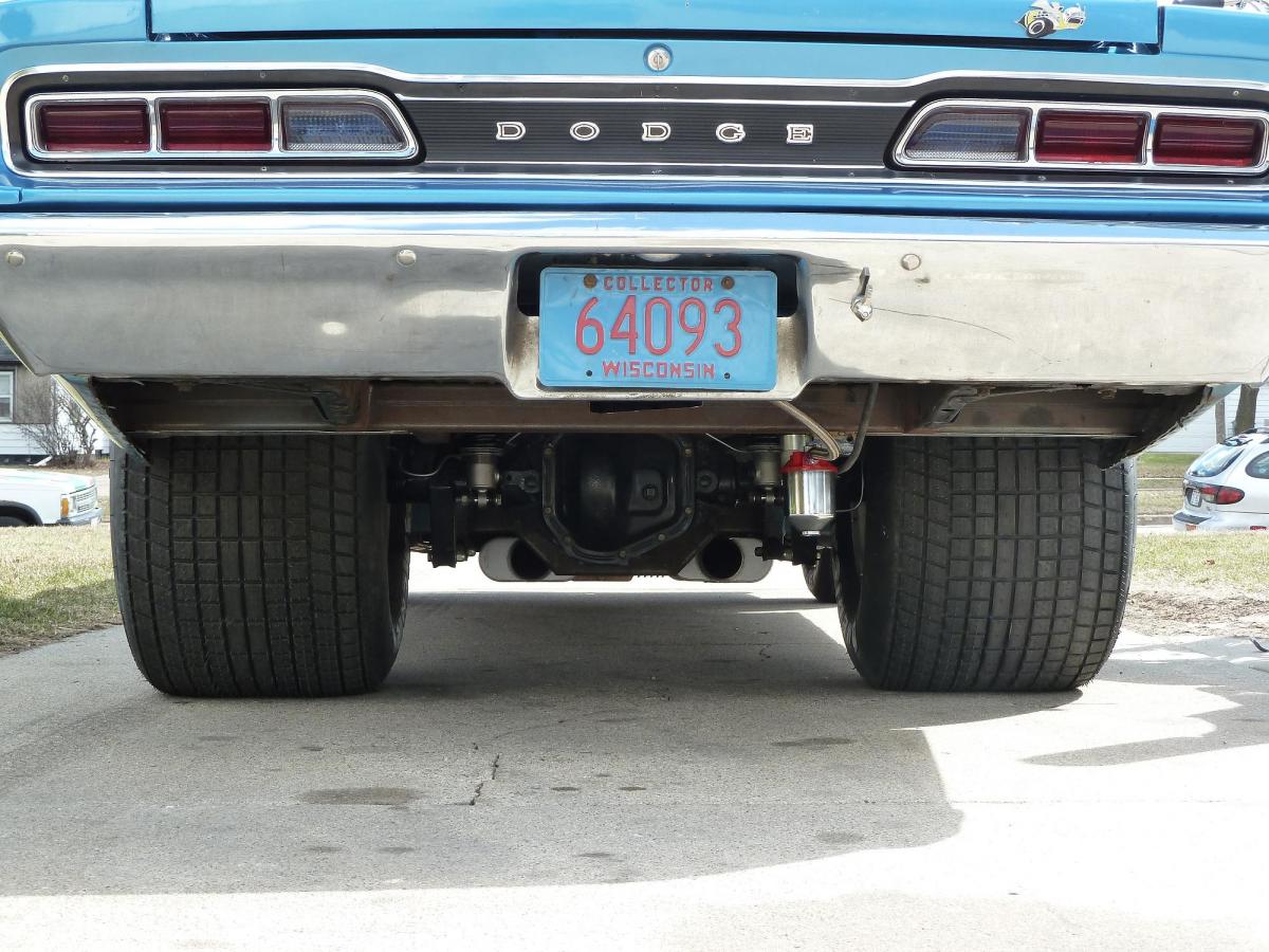

295-65-15 BFG drag T/A,Mopar Performance Hemi springs
Beezee, what is your wheel size and back space if you don't mind? Good looking car!
