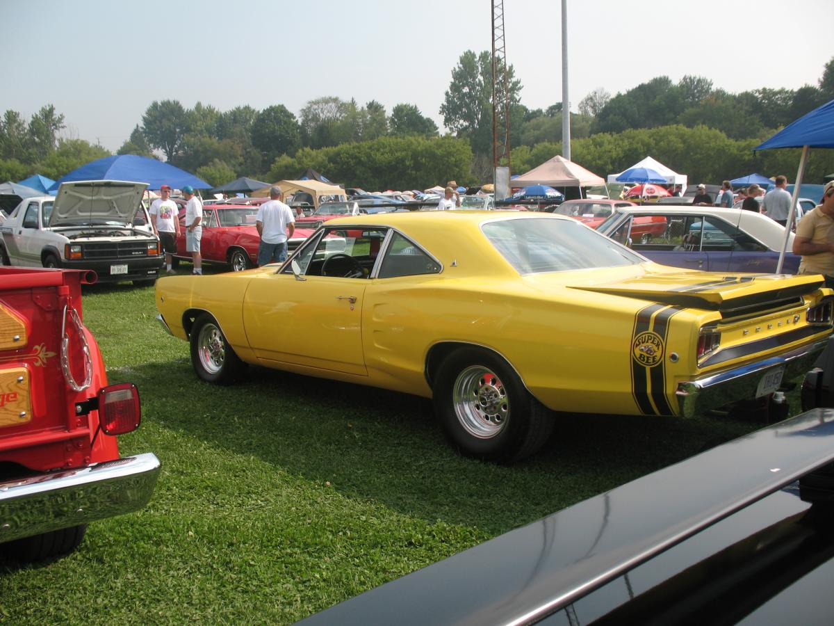

My Super Bee is wearing 295/65/15 on the rear with MP Hemi leaf springs 15x8 weld rim,doesn,t rub. 215/75/15 on front 15x6 rim

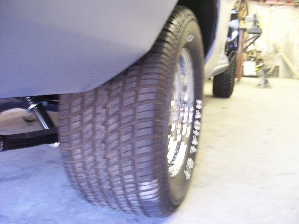

295/50/15 68 chrgr. i tempararly removed the rear leaf spring shackles, and carfully lowered the car.this size tire would go into the wheel well with about 3/4" of clearence on the outside and about 1 1/2" on the inside.great fit.these tires are on 15x8 wheels w/ a 0 offset.
