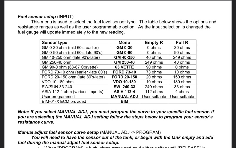

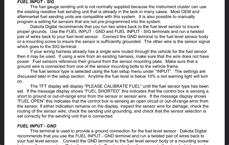

I am looking at the Dakota Digital Dash and have been doing the research on the fuel gauge because I want to know how to set it up. There is a section in the installation manual about a specific way to ground the fuel gauge. Did you follow that? Also did you try changing to one of the pre programmed settings to see if changed any response?
