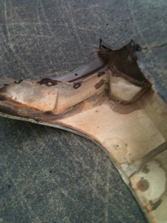

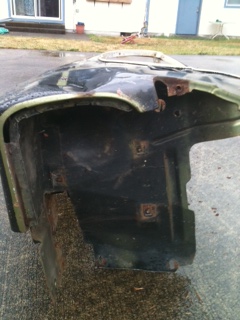

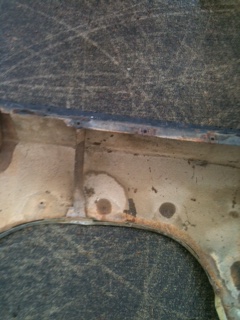

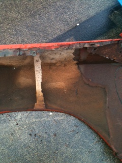

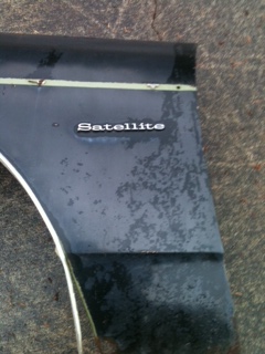

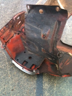

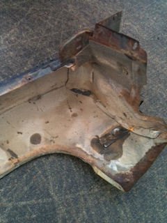

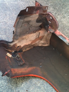

Correct and True because one of my fender still has the original factory paint and the inner headlight buckets are unpainted galvanized steel buckets and behind that is flat black.
Here are a few pics of my Roadrunner's hemi orange fender and a black Satellite's fender.

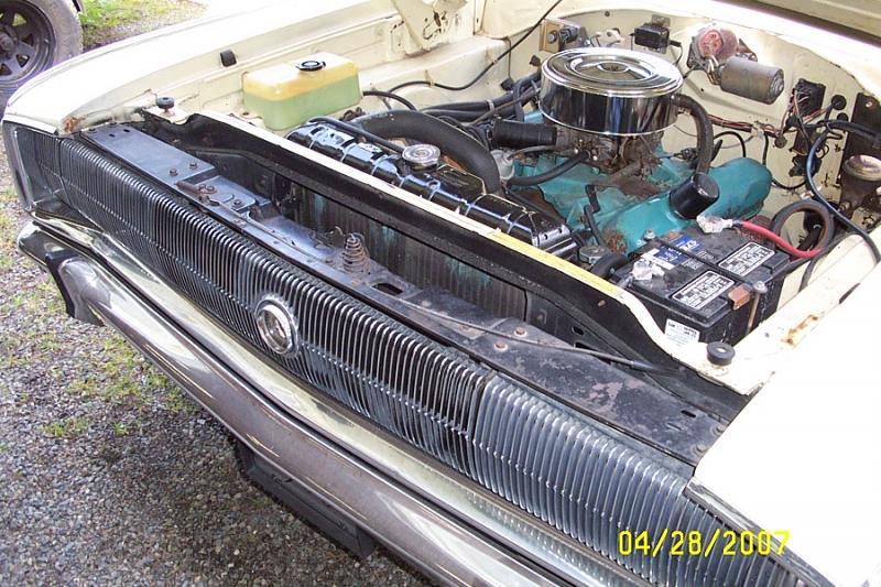

my 66 Charger....pay no attention to the corrosion on the radiator...it's been replaced since pic was taken. This is an original car...note upper rad support painted as well
Bryan

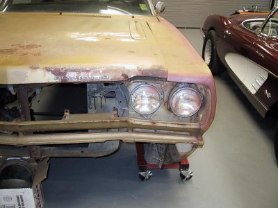

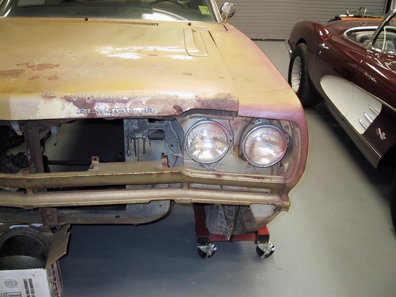

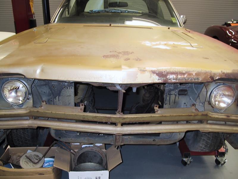

Here is a sloppy one on my Road Runner before disassemble.
