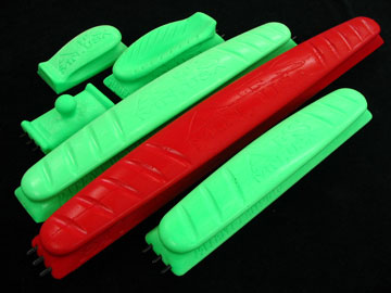

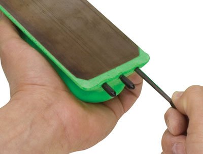

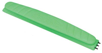

These are what I use, Adjustible Flexibility Sander (AFS). They work great! I have a number of homemade blocks also, but I use these the most. The less rods you use, the more flexible they become. You can get them from Eastwood or other places like that.

They work very well. I've had mine for quite a few years now. I bought mine locally, because the guy that invented them is from Minnesota. They are a great product.
