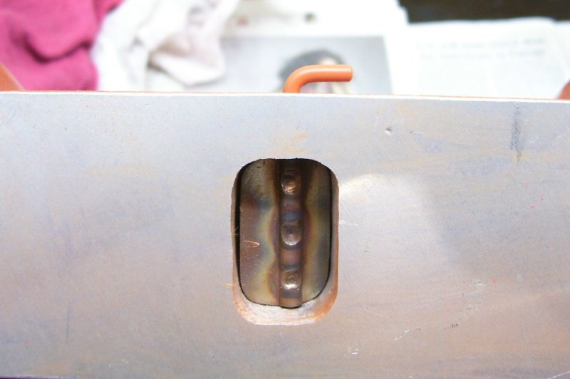

I welded 1/4" aluminum plugs in my 6 pack intake. I have been using it for decades this way. I installed a manual choke. The stock choke thermostat adjustment can be loosened up to just close the butterfly and open sooner. You wouldn't block the heat riser passage if you were not looking for more performance/fussier cold operation.

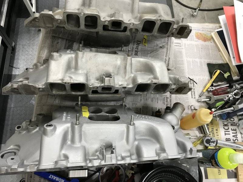

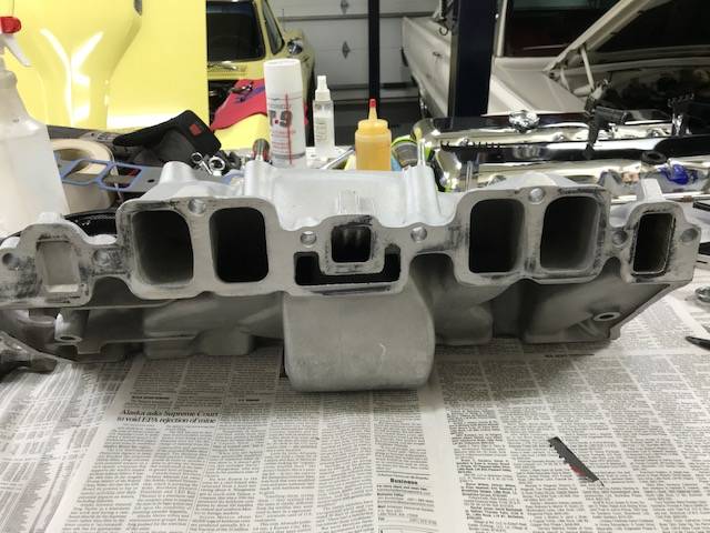

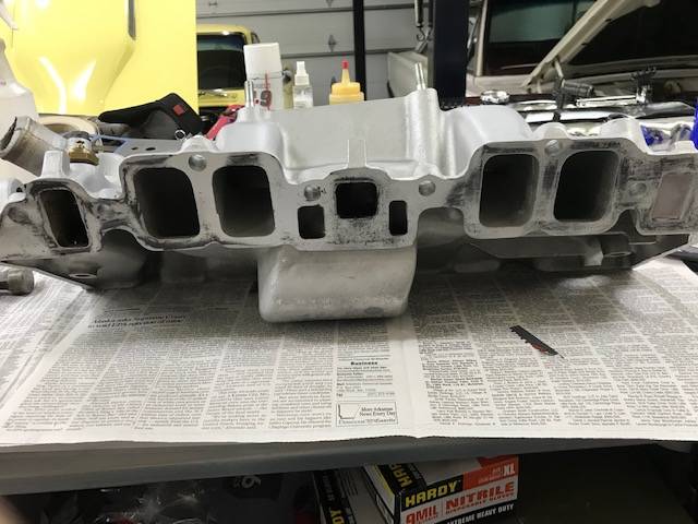

I’m afraid I will be the devils advocate and get slammed here but I just swapped a different (used) L72 aluminum intake on my 427 Corvette and had bad coolant and air leaks and it was due to very uneven gasket surfaces (warped???). I actually have 3, used factory aluminum castings for the engine and after straight edging all three, I found all of them were uneven with the worst areas at the bolt holes and at the heat riser crossover.
The bottom one was the one I installed that leaked and it has never been cut. The one I removed is in the middle and it had been cut and port matched to L88 heads. I ran it for decades but when I installed it I ran a bead of RTV around literally every port on both sides of the gasket so it never leaked. The upper one is an old casting I bought but never installed, never cut and it too is uneven. It appears to me that bolt tension and heat around the crossover - at least on these GM aluminum manifolds does distort them over time. With feeler gages I found gaps On the lightly bolted manifold, of as much as .011” between the gasket and manifold. A straight edge literally rocked across the heat riser on most of these surfaces.
The good news however is it’s relatively easy to fix with a good sanding beam and some 220 SA sandpaper.
I blacked out the gasket surfaces with a large sharpie, and used a almost new 24” machined aluminum level with a 1-1/4” wide base and 220 grit, I block sanded the surfaces with a careful crosshatched pattern until the worst of the black areas were gone and the manifold would sit loose on the gaskets without any place that I could slip a .0001” feeler gage in. I did apply a light smear of RTV on the gasket at the areas that were still showing some black as a precaution, but the areas could not really be detected by straightedge so the gasket would take care of them. A straightedge sat flat now and did not rock across the heat riser passages. It seated fine now and I don’t have any coolant leaks (bad before) and vacuum is holding steady.
Just my experience with a Chevy. But I wouldn’t let that prevent me from running an aluminum manifold. And B-block engines have a simpler intake gasket seating condition without water passages so that even if there is some waviness, they could be easily dressed down before installing.
