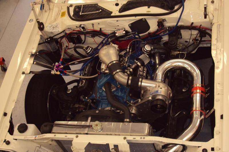

Made some heat last weekend. Running on out valve springs till the cam breaks in. All is well so far. Might get it to the track at the end of this month.

You are gonna love the instataneous throttle response that babys gonna have.. and good lord make sure you have enough pump to keep up...stuff gets ugly in a hurry when she go's lean. I don't know if you installed a boost cooler-I would & I did on my engine..sno-performance stage 2 has a digital boost controler set it for when you want it to start commin on & full on @ such-N-such boost you can use windshield washer fluid or boost juice...it helps cool incomming air & helps keep detonation from happening....good luck & enjoy...
Yes, went with a "Snow" system. Pump is to the far left ( on the firewall) and controller is just to the right of it. Using the middle size jet and got it set to turn on around 5 lbs. of boost. Running straight distilled water as suggested by Prochargers ( freezing is not a problem where I live ). Haven't had a chance to get out to the track as of yet, but pretty impressive for the little bit of street time I have on it. I'm running a filled block and the oil temp is a little higher than I would like, so I am about to install an oil cooler on it. Went with a "Magnafuel" fuel system ( tank to carb ), so don't think I will have a problem there. "ProSystems" redid my 950 carb for a blow through application.

That is sweet lookin set up ..hopefully you get a few passes at the track before the season is done...I know I'm trying to get a few passes in myself...I haven't even had the chance to fire mine in 2 years & I'm starting to get anxious now...make sure you keep an eye on your plugs...and if your after any super charged tech info steve morris on yellow bullet totally dedicated to superchargers & blow thru carb/injection set ups...very informative & will find useful info from making a costly mistake...enjoy looks like a blast to drive

Actually bought my "package" ( blower & fuel system ) throught Steve Morris engines. Told them what I wanted in the way of HP and I let them put the rest together.
