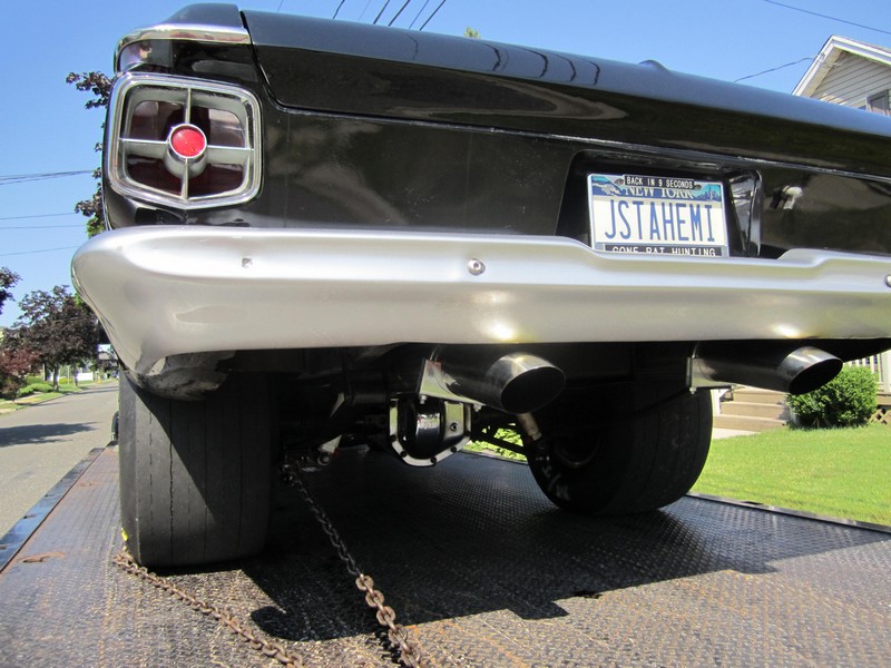

So today I decided to make a mini me key chain as I do with all my cars and not 10 minutes after snapping these pix, I blew the rear end right in front of my shop :sad6:
I manged to limp her into the shop and got her on the lift, but found a not so sweet spot where I can spin the DS and have the wheels do nothing :puke:
Most likely munched a chunk out of the ring gear :(
What's funny is that I did the same thing in one of my T/A's years ago in the exact same spot lol
