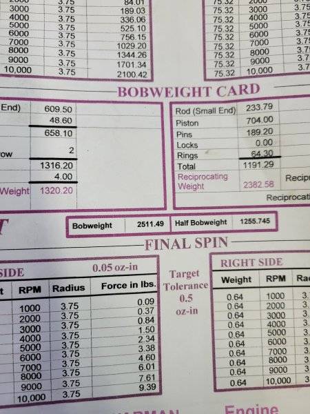

Here's one with icon pistons
The lightest I've run with 4.500" bore, 7.100" steel rod has been 2222 grams. Currently 2360 grams with a thicker pin and slightly heavier piston. Rings make a difference. one complete cylinder set of .9mm were 25 grams lighter than a comparable .0430"
Doug
…..and, the 5/64” ring is about 11 gr. heavier than 1/16” rings
I just balanced a stock piston 383, Bob was 2460 and a 440 with 2295s using stock pins so very close to stock, Bob was 2580ish, might be off a hair but the notes are in my shop, I'll check it tomorrow.
