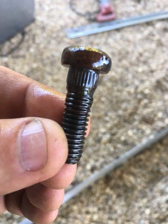

I'm going back on with my rear suspension and axle. I seemed to have misplaced 1 bolt that attaches the leaf spring to the frame just in front of the rear tire. There are 4 bolts. Can anyone tell me the type and size of the bolt attached for a 1969 Dodge Charger?
That's a tough one. That's a stud from your front leaf spring hanger. I've never removed those. I think the easiest way would be to pull one from a salvage yard & I'm 99% sure they're all the same, car & truck, for many, many years.
10-4 Thanks. I figured with the wealth of knowledge on this site someone would have removed and replaced these before.
How many do you need, I got new ones with my 4 link, I should still have the old ones you can have them
I have removed and replaced these...very easy to accomplish. Tap them out with a hammer. Press in with a press(if you have one) if not you can easily draw them in with a short socket/tube with the nut...
I have a set but I don't want to break up a set....
Call rt specialties and he will sell.you one.
