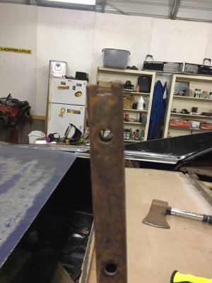

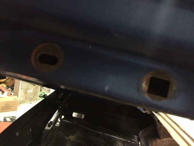

Ok, please do not ridicule me as I already realized I didn't do a good enough job of taking note of all bolts and things I've taken off my 69 Charger. But can anyone show me what size bolts and fittings are used to bolt the trunk lid to the hinge? I'm trying to install it to give me an idea of how much I'm off on the rear end and I cannot find or remember what was used to attach it.
Thanks
I believe they are the sam ones used for the hood.
Is there some kind of washer or something else that it will screw in to? I'll have to post a pic f what I have and I'm missing I guess.

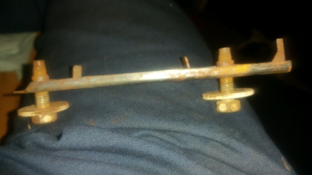

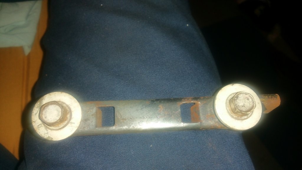

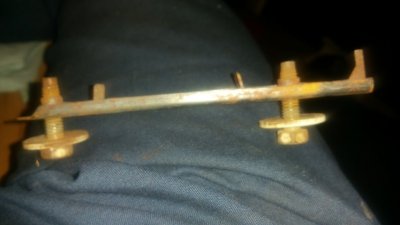

They should look something like these, although this is from a 67 Coronet, yours should be similar.
mine are the same as rtk (68 charger)the bracket in the pic has the threads and it slides into the trunk support arm there probably still in there. if you take them out they fit in either way, but if there put in backwards, and tighten them down they break. the pic shows the correct side where the bolts go into.
