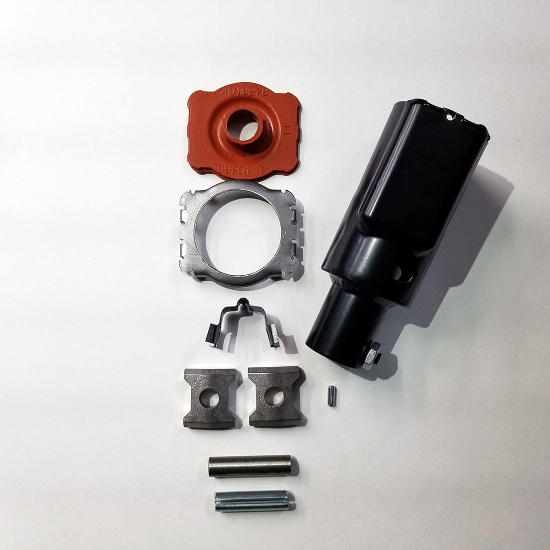

I'm in the middle of the Borgeson Power Steering conversion. are there any good instructions here on the Modifications required to the Steering shaft. Im just trying to make sure I get it right.

Call Peter at BAC, one of the sponsors here on the rh side of your screen, before you hack the shaft.
type in swapping a borgeson steering box in search
I've just done this swap. Bergman Auto Craft (FBBO Sponsor) makes a coupler that requires no cutting of the shaft. And yes, kerndog's epic thread (link above) on this topic is a great place for reference.
When you received your new steering box, did you get the needed fittings for the lines? If not, thats another reason to contact Peter.
