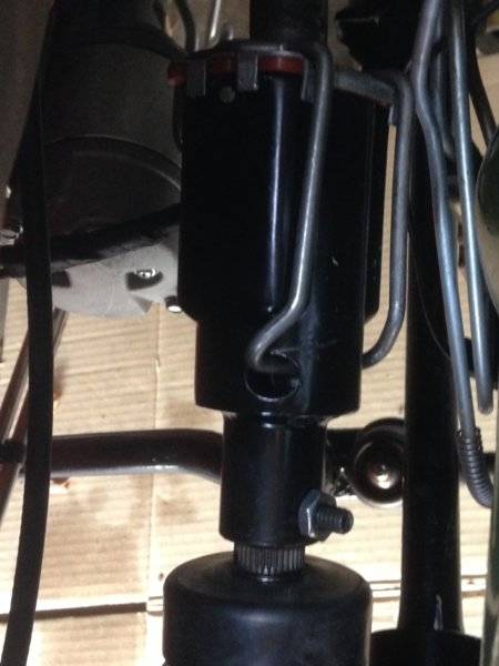

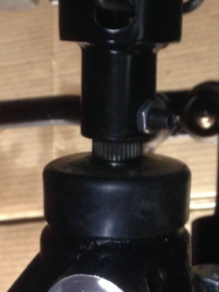

View attachment 727583 View attachment 727584 Hi Frank,
Make sure the box is centred before installing the pitman arm. The instructions that came with the box, and also the bergman coupler, show how to do this. Yes, this is done before installing the coupler to the box.
There are no alignment marks on the borgeson steering shaft for the coupler. The two pin holes are probably the marks you are referring to from the bergman install sheet. These marks indicate that the shaft is centred. One hole at 10 o’clock and the other at 4 o’clock.
The coupler comes down on the box steering shaft enough for the screw to sit in the groove and lock it in place. Once it is all to your liking don’t forget to put loctite on the screw.
The coupler gets grease packed into it before putting on the seal.
Cheers, Glenn
Monroegtx:
I really like that clamp you’ve got running from the roll-pin hole to hold the coupler cap on. Was considering running safety-wire but this looks much cleaner!
It’s a good piece of gear, and as you said looks nice and clean. Works great when the tabs on the cap just down seem to do their job. Here’s a link if you’re interested. https://www.detroitmuscletechnologi...steering-column-coupler-cover-clamp-retainer/
It’s quite a strong clamp. Cheers.
Glenn.
