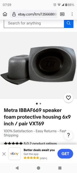

Have you considered foam enclosures? Easy, economical, small in size.

This is a foam speaker enclosure. If you make a hard box to enclose the speakers you risk 'tuning' to a certain frequency that could ruin the sound quality. You can Google 'tuning a subwoofer box ' to get an idea of what I'm talking about.

This is a foam speaker enclosure. If you make a hard box to enclose the speakers you risk 'tuning' to a certain frequency that could ruin the sound quality. You can Google 'tuning a subwoofer box ' to get an idea of what I'm talking about.View attachment 1841443
A foam speaker enclosure has a tuning component, whether its beneficial to the case at hand is subjective and likely happenstance. There is likely no magic to the foam, other that its likely cheap and lightweight.
