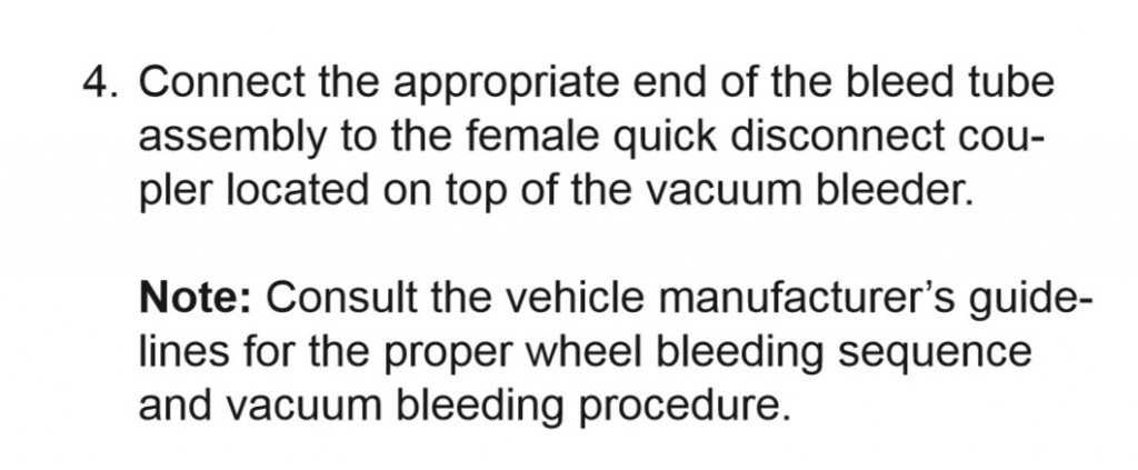

Curious to see what their instructions say on how to use it. Wondering if they say to remove the lid on the M/C and what not while bleeding.
Funny - I have a Mightyvac and never read the directions. I always used it like everyone else, farthest wheel first and it's worked so far.
Mityvac instructions say,
